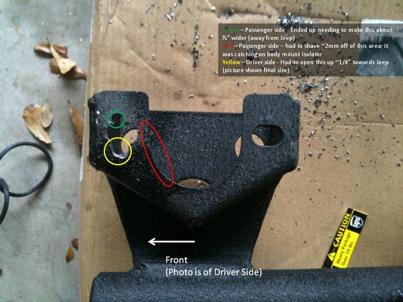

This will make more sense once you're underneath the JK. Decide where and by how much you need to enlarge the hole(s) on the front mount. Be sure to note if it's toward the armor tubing or away from it. (On both sides I made my initial holes in the wrong direction because I forgot that I was upside down when I decided which way to cut, but right side up when I did the cutting.)
After you get a good first guess, take the armor off and go to your worksite. My approach was to use the drill to put a hole in the armor and then go up in drill bit size until I got to my 1/2" which basically connected to Smittybilt's slot. Unfortunately since I don't have a drill press I had to do the best I could with the hand held drill. Then I got out my rotary tool and very slowly (with lots of spray lube) tried to enlarge the hole/slot, using a file as well. Then it was a trip back to the JK to see if the hole was big enough. Nope, back to the garage to make it bigger. Lather, rinse, repeat.

The less than pretty "adjustments" I made:

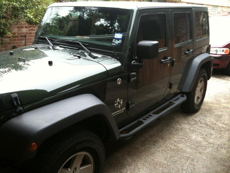

After:
Love the look, hate that it took so long for as much as this costs.
