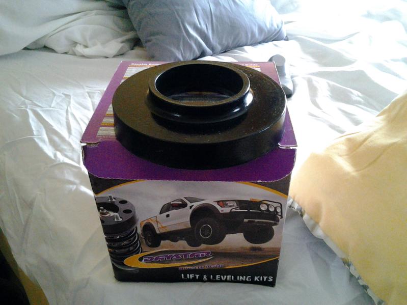

I'm running a 4" Skyjacker lift with XHD Bumpers tire carrier and warn winch... I'm only putting 3/4" Daystar coil spacers to make up for weight loss (only 30 bucks on Amazon for the set of 4)
And I wouldn't put ANY more that a 1" spacer on top of existing coil lift
