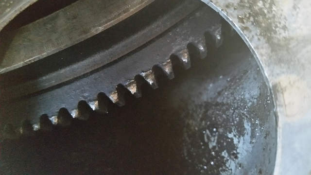

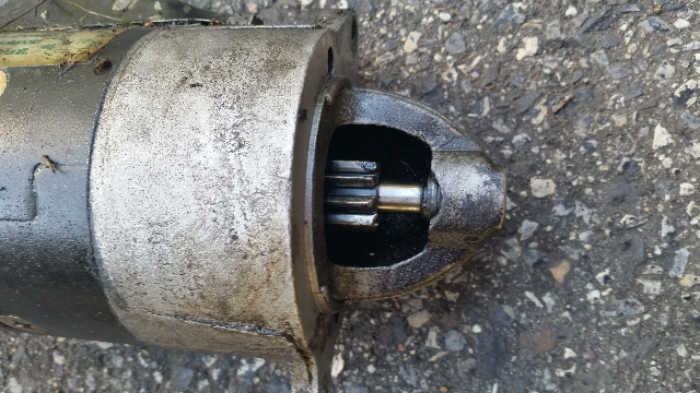

Yeah it was the starter...but it grinded the flywheel.
