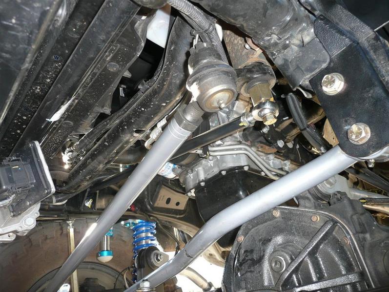

Here's a pic of the ORE sector shaft setup...

Thanks for the pic, that gives me an understanding of how it works.

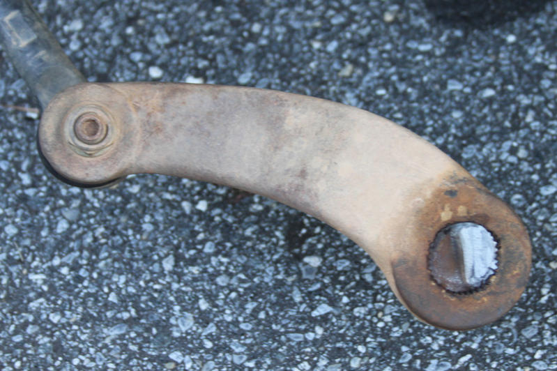

This was mine this morning in the parking lot. I had already taken 2 trips...glad I was not driving. Running 37" Grapplers. You can not just replace the shaft? You have to get the whole box?

Ugh you have to be kidding me, ANOTHER JK problem?! It seems like everything on these is vulnerable once you add tires.
FYI - This picture shows a drop-bracket for the trackbar. If you don't use a drop-bracket, you'll need a good 3"+ bumpstop to prevent the trackbar from contacting the sector shaft bolt. I'm using a 2 3/4" bumpstop and it's too short (real-world testing by installing it and stuffing the driver's side).
