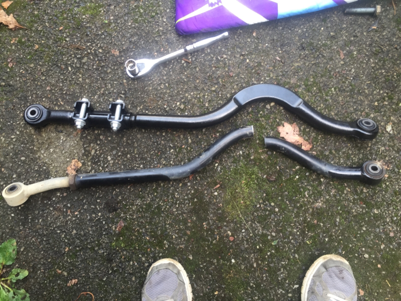

It wasn't stock. I will post a picture of it when I get it out. Got a new one love when I live 45 min from summit racing Got a teraflex
Old Aug 31, 2015 | 05:47 AM
Darb24's Avatar
Joined: Jan 2015
Posts: 107
This is the broke and the new one from teraflex

Old Aug 31, 2015 | 06:07 AM
tribulation138's Avatar
Joined: Nov 2012
Posts: 849
From: CT
Wtf holy shit.. maybe the metal had a defect
Old Aug 31, 2015 | 06:19 AM
jchappies's Avatar
Joined: Jul 2013
Posts: 644
Likes: 5
From: Santee
I would start looking at your other front end components and make sure nothing else is damaged.
