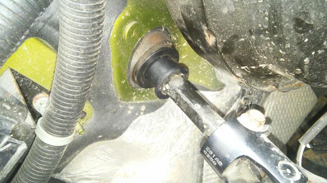

I took a look at the bushing in the steering shaft. It looked to be a little out so I pushed it in as much as I could. This is what it currently looks like.

I went on a local fire trail last week and the knock came back around half way through, but not as bad. I was in 4lo if that makes a difference. When I got home the bushing didn't looked like it moved but I gave it a good push anyway. The knock is gone again. I think it's related to the bushing but not sure how to replace it
