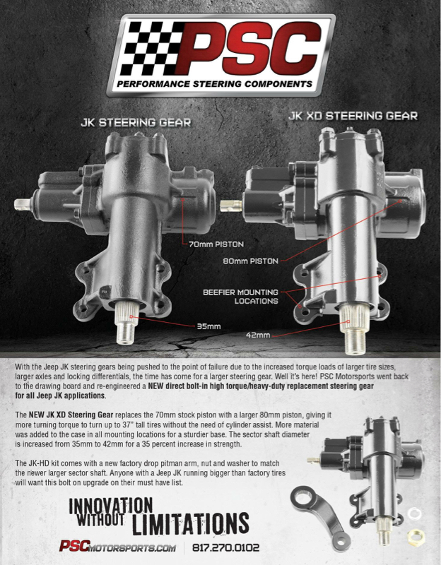

Never looked at it that way honestly. I have my name on the preorder list for this though ...

I looked at that thread as well. My initial thought was if I'm going to blow $900 on that, is it better to just go all the way, do hydro, and be done?

I know PSC says 37's max. Mel Wade is running 40's without a issue. Well a bent stock drag link lol
OP.. PSC is running the new box and Yeti links.

...I am greatly intrigued by that new PSC box though; mainly if it's really going to be enough to get locked 37's turning with relative ease. I've got a bum shoulder now, and turning while locked just ain't happening anymore, and really need to get something going on the new jeep. Likely just going to go hydro assist again, but if this box would do an adequate job without the twitchyness, that would certainly be ideal.
Me too. I'll have a Synergy Sector Shaft kit for sale shortly. Brand new / never installed....
