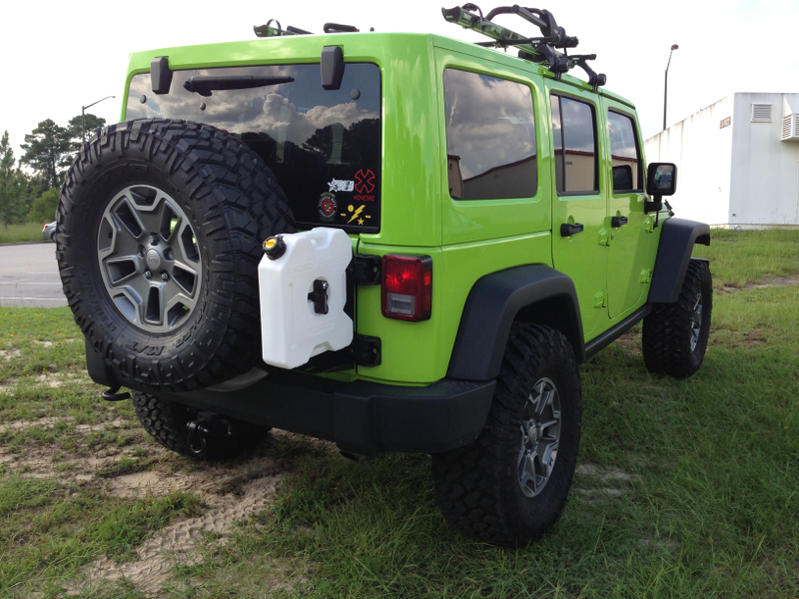

Thanks to all the guys who chimed in for me. It was my track bar. Tightened it up. Good to go. And just for good measure, during the same time installed rotopax on a teraflex accessory mount and VDP stubby bumper end cap kit.

Glad you got it sorted out. Your rig is looking good.
