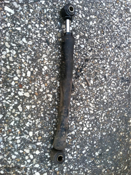

Easy DIY. Check out the install instructions with the kits.
You don't want this happening but I drove home 120 miles and couldn't even tell it was broken.
