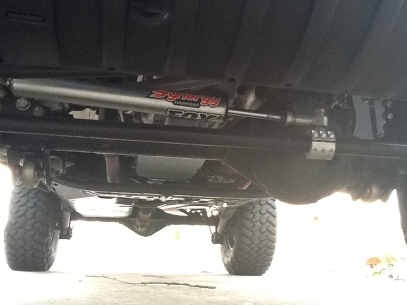

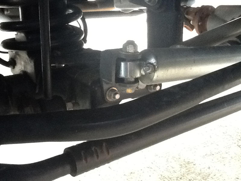

Huge difference from stock. I have the Fox with relocation brackets. Make sure the alignment geo is correct as well. Stabilizer only stabilizes, it doesn't correct!

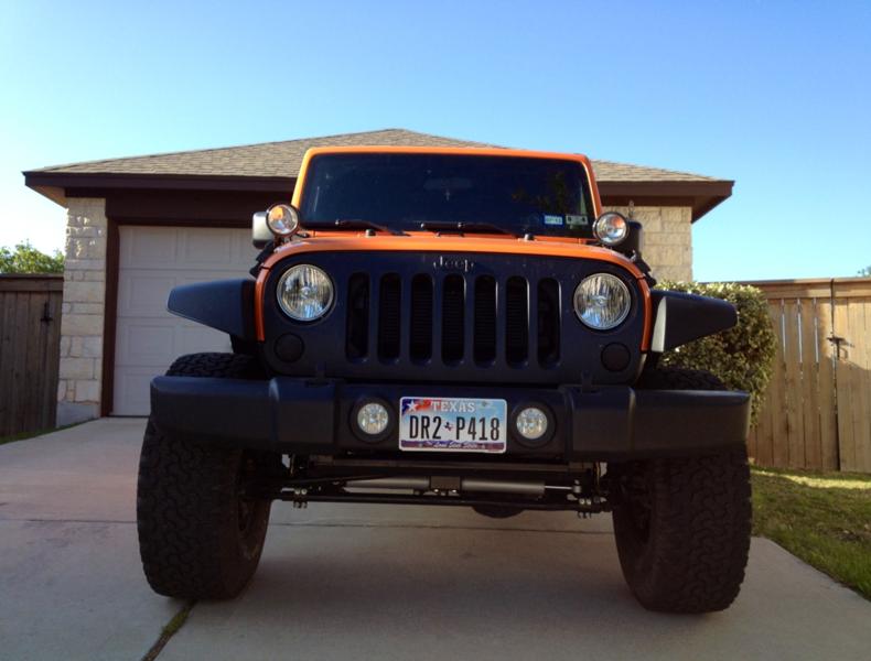

I have the Rough Country dual setup and it certainly helped with the "wandering" feeling generated by my tires... As stated above though, it definitely helps and does not fix a problem.. Even after I put mine on, it still wandered a bit and it was 100% the steering and alignment geometry... Good luck...
