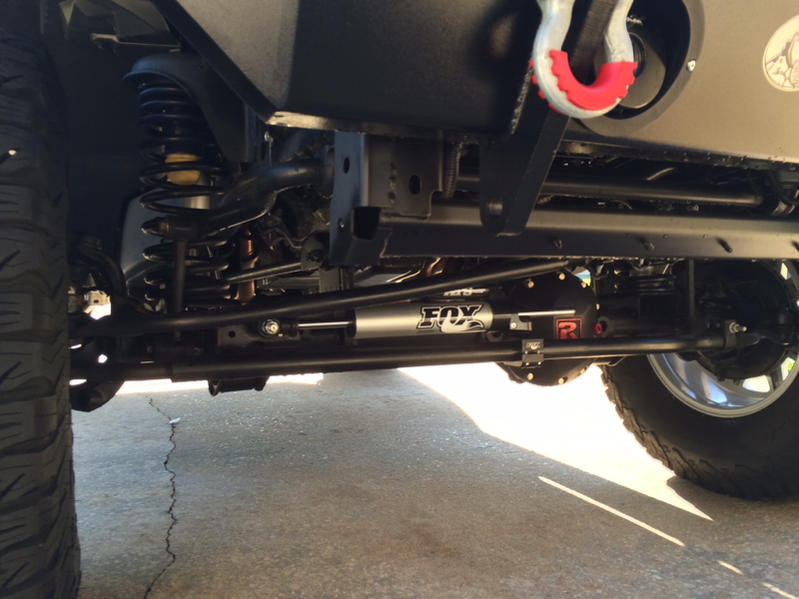

Fox ATS works nice. 14 clicks of dampening. Best mod for me.
Sent from my iPad using JK-Forum
