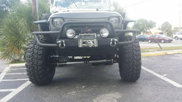

No a stabilize won't make a huge difference. Check track bar and drag link. I got a dual and it's no different. So if you have yet to buy go basic.
