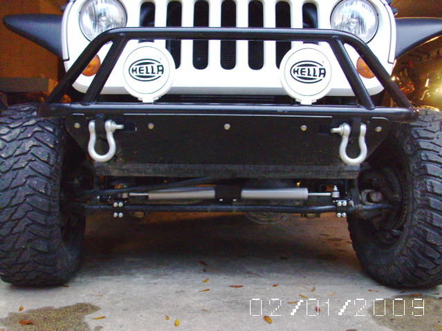

I think it looks cool too, but didn't really do anything special. My frt is pretty dialed in with no bumpsteer and tracks straight as an arrow. My Superlift stabilizer was all dented to sh@t and that's not including that it came pre-dented from the factory I'm not one to just wait for something to fail first, so I got the duals, it may help when I go to 37's.
