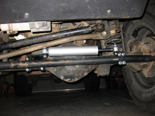

I went with HALF of the Rough Country Dual SS setup. They sell a relo kit that puts a single SS on the driver's side. It really is the same axle bracket, shock and tie rod bracket that the dual kit gets. I have the Rock Krawler tie rod and drag link and they are a larger diameter so a SS wont fit on the psgr side. It is a nice kit, and the shock is beefier than most SS.
For what its worth, another manufacturer is going to be coming out with a dual kit soon also. Not sure if it is top secret or not... Their initials are R and K (and end with ock and rawler). Their setup is supposed to use Bilstiens too. Might be worth waiting for...

Oh yeah... here is a pic and also my write up...
https://www.jk-forum.com/forums/jk-write-ups-39/rough-country-ss-relo-kit-write-up-72921/
