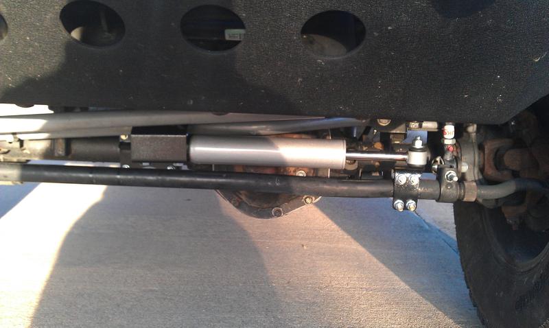

Hey guys,
I have had a stock stabilizer on mine and just switched it out to the rough country dual yesterday and was only able to use one side due to my Rubicon Express drag link but it helped tremendously on the bump steer for the 35's.
I am trying to figure out how to get that second one on there without loosing my aftermarket drag link because that helped as well.
The stabilizer is very important if you take it off and you already have one you will see how much it helps. Also it will affect your tire wear if not working correctly just like a shock will.
NTX RUBICON
