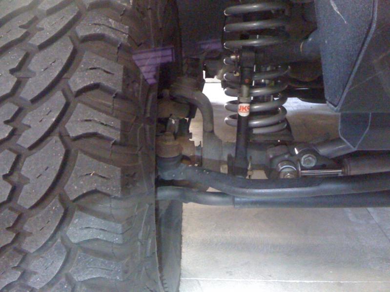

So I'm having ridiculous issues with bump steer now with my lift and was wondering If it's worth investing in either a currie hd draglink and tie rod system or rock krawler similar system or should I just stick with a dropped pitman arm and save a couple hundred bucks?

are you saying that you have a dropped pitman arm installed now and if so, do you have a track bar relocation bracket installed too? if not, that is your problem right there. you NEED to have both installed.

Usually bump steer and death wobble are caused by either miss-aligned drag link/ trakck bar angles or worn out bushings/loose bolts.
Take a pic of your front geometry and post it.
With most lifts over 2.5", I'd consider the high steer option. I run high-steer and a 4.5" lift and the stock pitman arm with no vibrations whatsoever.

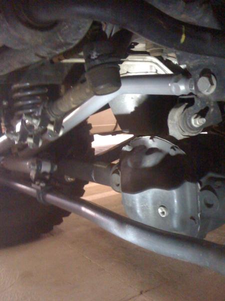

As you can see, all I have is an adjustable track bar. No dp arm and no relo bracket. So I guess as Eddie is sayin I need both or can I just do the high steer kit an be good?
installing both a track bar relocation bracket and dropped pitman arm OR draglink flip will help improve your handling as it will restore your steering geometry back closer to stock again. you cannot just do one or the other.

to run a "flip" u do NOT need the tie rod bar. u NEED a flippable drag, like the currie, AND a track bar relo bracket like WOL said.

Okay, I gotcha. So I'll either go with the currie or teraflex flipped draglink and a relo bracket. Thanks guys!!
