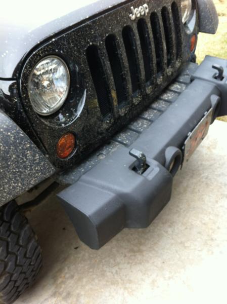

I did the stubby chop on my bumper. I also didn't like the open ends. Then ends can be folded over but sometimes doesn't look great and seems difficult. Guys have done it though and it looks good when done well. My solution I bought a Rubbermaid tub for some donor plastic. Chopped the ends, used some cardboard for a template, then cut it out in plastic. I then used the a soldering iron to melt the pieces together. Then a good coat of bed liner and I'm happy with it....for now!

Beauty! That's just the look I'm after! I'm on my cell so the picture kind of blows, but your saying you sprayed the whole bumper?

Yea the outside of it anyway. After melting the pieces back together I ground the rough edge down with the dremel. Then sanded the bumper down to give it a key so the liner would stick. 3-4 coats if I remember right. The reason I left it as wide as I did is I wanted to use stock hardware to reattach it. I could have gone a little narrower if I wanted. Hardest PITA is getting the bumper off and back on.
