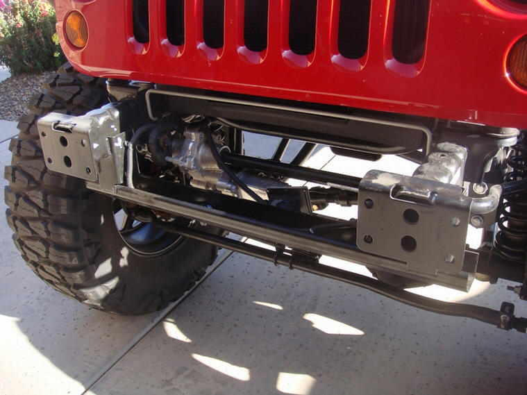

Nope, that part is clearly bent and is included in the original estimate. What I'm referring to runs from left to right across/attached to the frame rails.
Ok, found a picture online, not my Jeep, but this shows the bar I'm talking about... It's the u-shaped bar running across just under the frame rails...

It's not structural. Several manufacturers use it as the attachment point for a heavier-duty front skid plate. Some aftermarket bumpers require its trimming or removal alltogether.

Makes sense... my concern is that bar got bent forward on the opposite side of the bumper impact... which indicates to me the frame rail on the impact side moved inward and forced that bar to bend outward. It's not a major bend, but very obvious... probably not a difficult fix for the body shop, but I don't think it's anything I can do myself as I suspect bolting on a new bumper will be an issue when the holes don't line up...

Got the Wife's bumper all fixed up... The little run in with the pole ended up being over $4K in damage! Once the bumper came off the found that the crush point on the bumper was,well, crushed. So, they ended up replacing half of the frame rail on the passenger side.
