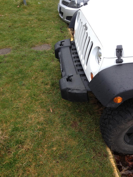

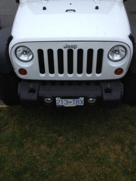

I cut the ends except for the front plastic. Then I took a propane torch, heated it up and bent it back. Then I just took a hot knife and melted the pieces together. Its not 100% cosmetically appealing, but I like it, it works and I'm buying a new winch bumper in a little bit anyway.

Is it a pain to cut thru the metal piece on the bumper?
or did you go thru it like butter?

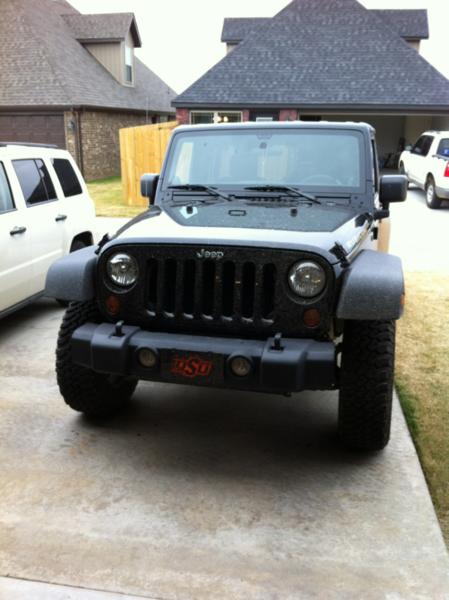

I did mine and cut new ends from a Rubbermaid tub. Used the hot iron trick to melt back together, sanded down the edges and hit it with bedliner. As for the metal part of the bumper, my dremel with a composite wheel cut it pretty easy.

That turned out great!! Don't suppose you did any kind of write up on it? That is how I'd like mine to look. So that's just cut out 'homemade' end caps bedlined? Love it!

looks nice!
