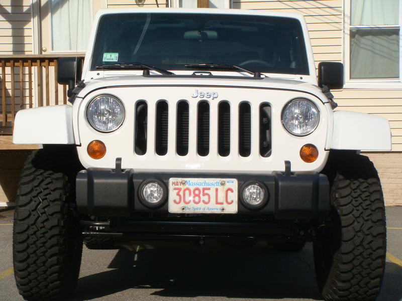

well, i just made my own stubby. i pretty much followed this write up -
http://project-jk.com/jeep-jk-write-...umper-write-up
im happy with how it came out.

Old Feb 28, 2012 | 12:36 PM
Runewolf1973's Avatar
Posts: 965
From: Red deer, Alberta
Attachment 283151
Looks really good!
Old Feb 28, 2012 | 07:45 PM
sknahsb's Avatar
Posts: 81
From: St. Louis, MO
<img src="https://www.jk-forum.com/forums/attachment.php?attachmentid=283151"/>
Happy to see another all white jeep with a stubby...looks great.

Old Mar 1, 2012 | 04:51 PM
Arctic's Avatar
Posts: 28
From: Attleboro, MA
thanks man. good stuff
