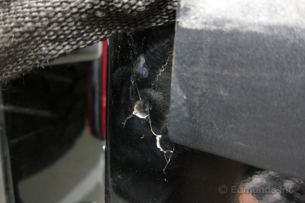

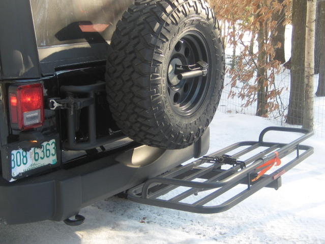

Default guess your not very observant !
Originally Posted by jnabird333
I would like to see a picture of a JK hinge failure. While I've read that the hinge will fail several times I have yet to see a single picture of one in person that has failed.
This was an issue on earlier models but the JK has vastly more structure for the hinge. In fact, several aftermarket carriers use this structure to mount their carrier.
The spot weld failure is a real issue but is also usually brought on by running a higher backspacing wheel the no longer touches the rubber isolators. Since nothing is controlling the "wiggle", It causes the failure.
FWIW, I know two guys that have been running 37s on the stock carrier since 08 & 09' and have yet to have an issue. But they control the "wiggle". One just with Daystar extended bumps, and one has a hitch mounted contraption and extended bumps. On the flip side I've seen spot weeks fail in weeks after running a 34 and not controlling the wiggle.
Also, the gate can be purchased for about $250-$300. Paint should run no more than the same. If someone paid $1500 they got taken.
>>>>>> https://www.jk-forum.com/forums/modi...e-42450/page6/ <<<<<< or fab for me !
not to mention if you think your getting a new door [ainted on the back of a 2011 - 14 aerosmith has a song for you
>>>>>>> (http://www.youtube.com/watch?v=92SIK4O2UD0)<<<<<<< ( the one with the crack is not mine ) the one with out the crack and or fab carrier is mine

Default im not a expert on tailgate carriers but
i have been trouble free with the OR -FAB carrier one year on my sport and Two years on the rubicon , ( 3 )years and not a squeek or movement ! just saying you dont need to spend a fortune but you do need to get ready to drop some cash or youl buy a door paint job and a tire carrier all at the same time in a moments time when it could have been avoided if you just got one right from the beginning just my op but its honest

This is pictures of the spot welds failing that I already acknowledged is an issue. I asked for pictures of a hinge failure. It's interesting though that there are no shots of if extended isolators were used to control the wiggle or not.
