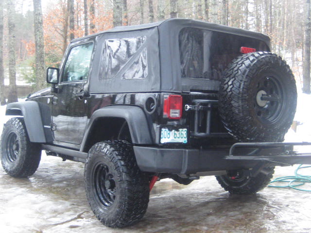

my 2011 sport was my first jeep i had no clue i was in for all the added expenses ! but the tires had to go and then i was mounting the tire and read they fail with heavy tires ! i asked on the forum here and every one said noooooooo get one ! so i did but ill say this , it was a pita to put on but its been a very worthy gate i feel . i guess the idea of opening one gate i can see, but i dont find it inconvieniant all to open the gate first .
in fact most people are asking about the gate it swings open very easy and the teraflex one wasnt out yet when i bought mine . i traded my sport and got the rubicon and removed the gate and put it on this one and again i still like its simplicity and strength and i can add more weight to it racks anything and its not on the door . the terea flex one broke shortly after there launching of this product . i believe they paniced over the incedent and scrambled to make sure it didnt happen again such as with thier heavy duty track bar break lol again redesigned quickly . so no further publicity would effect the sales ! never heard much about the correction in steel , im positive they did get better inspections , a 37 inch tire bouncing down the road or a 35 33 or 32 is nothing to brush off the shoullder like no biggie , i dont know anyone who would take that as insignificant to purchasing one . i just bought the teraflex hd monster track bar, i hope they made it better as well as the tire carrier thats all . quality control sucks on a lot of things we pay top dollar for . not all of us have endless pockets to empty out for a crappy product ! or dangerous more importantly .

i couldnt care less sock for every stinky shoe ! but as you read from other posters thier has been more than one incident and up for sale a lot maybe you could swing the used one ! me my self and i prefer quality , i dont want to see a tire passing me on my left and find out its mine maybe youl get second generation who knows ?
i like somthing you can build on , not another flimsy thing that when i want to add a jack i have to look for another product . id just bolt it to the carrier it has the holes all pre drilled and then ill add my jerry can holder and upper rack onto it too. love it !
