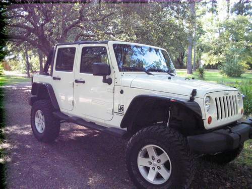

Mine have been on for 15000 miles, 35x12.50x17 with the spidertrax 1.5, checked every tire rotation, they haven't budged.
