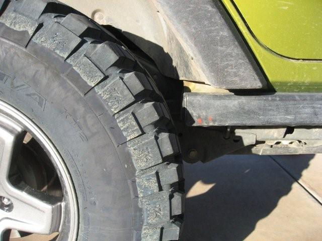

Here's what I did to solve the problem. First, I played with a few ideas where to cut the rock rail. I ended up cutting off 1 1/2" because it left a pretty good weld bead in place - it's not continuously welded. I know a few minutes with the welder could have made any place a good place, but lazy is what lazy does.

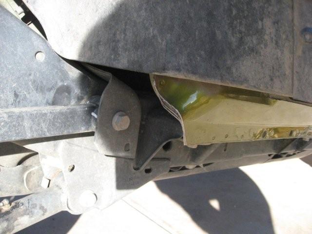

Next, I sliced off the pinch seam. Note the gap between the different layers. Mine was filled with some crispy foam and mud. I figured mud can't be a good thing so I used a screwdriver to punch the foam/mud back about 1/4" and filled the void with silicon caulking.
Name:	20081206_JEEP JK_Rock_Rails_2.jpg

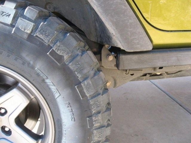

I primed and painted the cut ends. On the pinch seam, I just sprayed black paint in a bit. I put a dab of Goop glue on the end cap since I didn't want to re-drill for the goofy plastic retainer. I can still get the cap off easy enough.
Name:	20081206_JEEP JK_Rock_Rails_3.jpg
