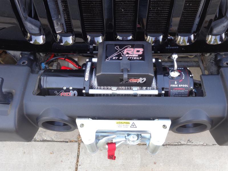

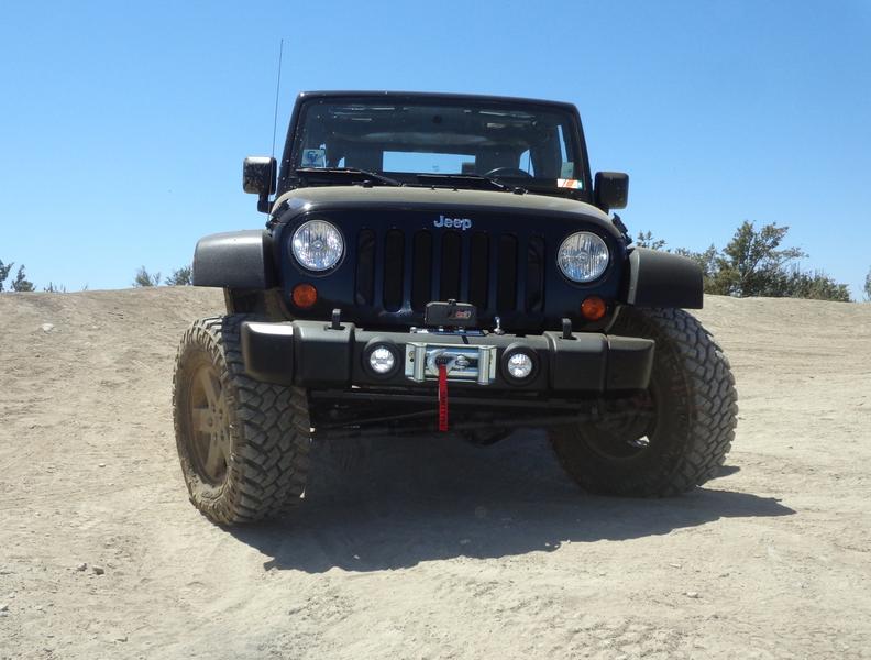

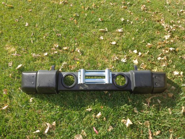

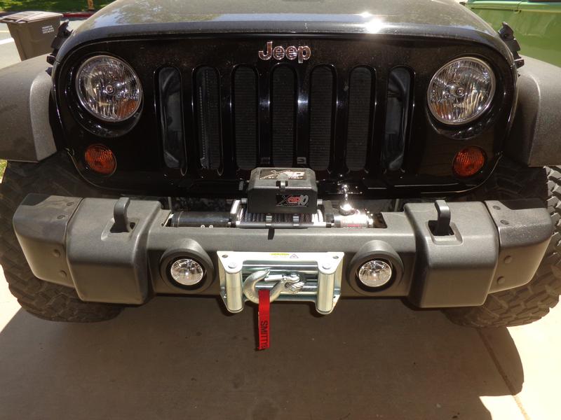

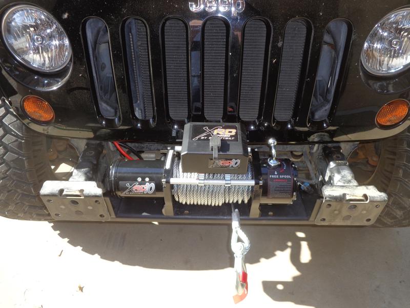

I too read all the "winch/stock bumper" threads. I went with a bolt in between the frame rail style, a Warrior products winch mount, P/N 507-174, it was like $150 too. It took me a little while as I chopped the heck out of the bumper, turned out fine though.
ID:	518160 Click image for larger version
ID:	518161 Click image for larger version
ID:	518162 Click image for larger version
ID:	518164 Click image for larger version

Attachment 518160 Attachment 518161 Attachment 518162 Attachment 518164 Attachment 518165
Did you have any clearance issues with the sway bar disconnect assembly?
