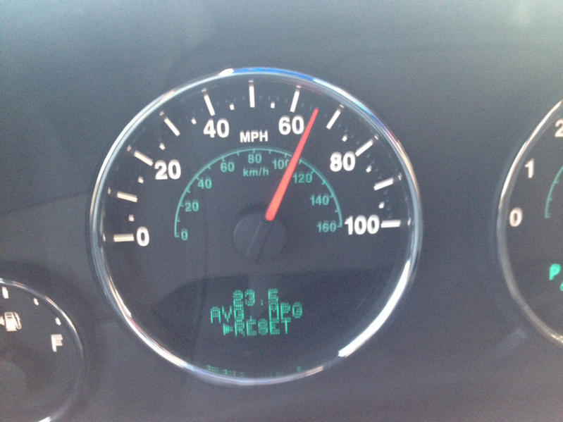

Before the flashcal at 55mph I was actually doing 56-57mph on a speedometer app off my iphone So it wasn't off by much.
Not to mention I have the 2012 with the 3.6 not the old 3.8 (horrible gas mileage engine)

As someone else said, yeah, no.
Make sure you triple check your speedo against a solid GPS.
I too have the flashcal, and have BFG AT KO 32" tires, i have to have my flashcal set to 31" tires in order for the speedo to be correct.
I can pretty much guarantee your mileage didn't magically go up when the only thing you did was something that would make it worse (getting bigger tires). The flashcal does nothing in the sense of a tune or performance.

We'll it did so I'm happy. Anytime when you lower your rpm's your going to see it in mpg. Adjusting the tires to 33.25" on the hwy this morning I saw as you can see in the pic 23.5 mpg for a good 15miles of hwy. So looks like it's working for me and the speedometer is correct.
