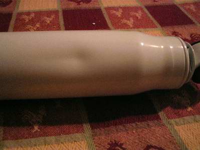

Did you get a pre-dented mod one like mine

This is why they send you so many Superlift stickers, all joking aside, it works great anyway , dents and all.

Acutally mine looks perfect and white .. no dents

Mine was also pristine... no dents or anything.
