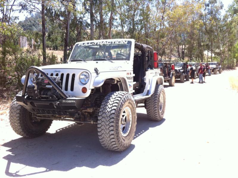

I would suggest our 3" premium plus kit for the two door wrangler. If cash is not a problem the 3" long arm.
The premium plus includes, front and rear trackbars, upper front and rear adjustable control arms. Featuring FK Kevlar lined chromoly heim joints, and torsion rubber bushings, bump stops, disconnects, and brakeline brackets.
At 3" of lift you really need to dial in your pinion and caster angles. This kit will do just that. Ive been running 3" and 37's on my 2 door for years. I'm extremely happy with the low center of gravity and ride.
If you go with our premium plus kit please let me know. I will include the proper bump stops for 37's and flat fenders. No need for a body lift.
