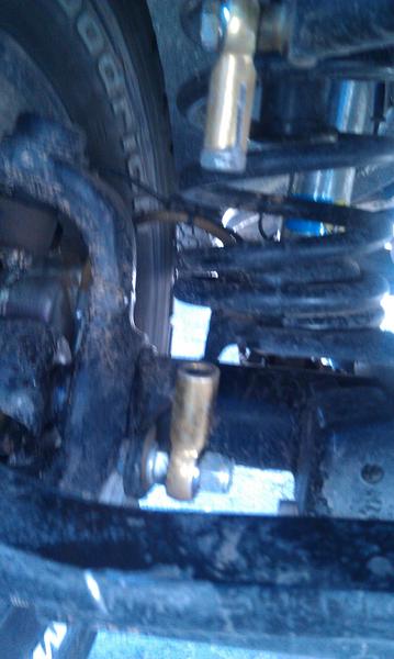

Installed an RK 2.5" lift with new sway bar disconnects. My e-disconnect, first time out, snapped the sway bar disconnects. I went out and bought some JKS Sway Bar Disconnects, amazing quality. Good purchase if you want to continue to use your e-disconnects. It seems it's not recommended and everyone out there is CYA and say to manually disconnnect.
Name:	broken sway bar disconnect.jpg
