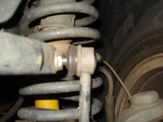

a few observations:
Shocks
N198 rear jk shocks x2
N196 front jk shocks x1
N65 ? x1 ( could this be the reason?) what difference will this make?
Coils
619 – Front
618 – Rear
The one front disconect looks like it needs to be tightened. There is a gap. Seephoto
ID:	33776   Click image for larger version
Old Dec 6, 2009 | 04:54 AM
  #54
explorer's Avatar
Joined: Jan 2009
Posts: 108
From: South Africa
i hope that the odd shock up front is the reaseon for the swaying jeep. Makes sense. I will then be able to sort out the alignment with the lower control arms.

Part #N65 is for an isuzu amigo,trooper or rodeo, I would say that would def cause a sway since it's valved for a lighter vehicle.

Swaybar link definately needs to be tightened. If it were me , I'd just get the correct replacement, chances of all your shocks being bad is really, really low. It been swaying the whole time you had these shocks on?

How do i check this? The light is not on in the jeep.
Now this only started when i had the track bars fitted and moved the rear swaybars to the front and fitted longer rear ones. is there a special way to fit these swaybars?
