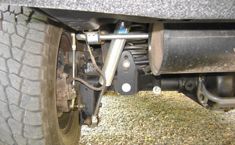

A awesome investment for any lifts over 3", is Full Tractions HD rear swaybar. For $189, it completely fixed my understeer, and greatly reduced my body roll. Cool thing too is it has 3 adj spots to place your sway links for firm road ride to softer flex ride. I'm very happy with it.

I took an expensive route and pieced it together: Rough Country 2.5" coils, added .5" spacer to front, 3/4" spacer to rear. Bilstein 5100 gas shocks. Warrior Products Front/rear lower control arms. RC adj front trackbar. Tera Flex HD axle mount rear trackbar bracket. RC front sway disco's. JKS rear sway links. Full Traction rear HD sway bar. Brake line extensions. etc...

The full traction sway bar really helped my body roll issues, almost completely eliminated the under steer (the feeling of the rear over swaying around turns or bumps, like the back end is coming out and around) much more comfortable on the road, and has adjustability/great performance off road.
