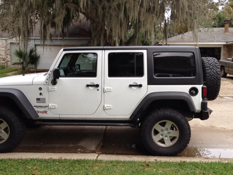

I have a 2011 unlimited Rubicon with 2 1/2" TF lift. I needed the 1" spacer to make it level. Still sits pretty level with winch and LOD midwidth front and rear bumpers.
Name:	jeep rubicon 001.jpg

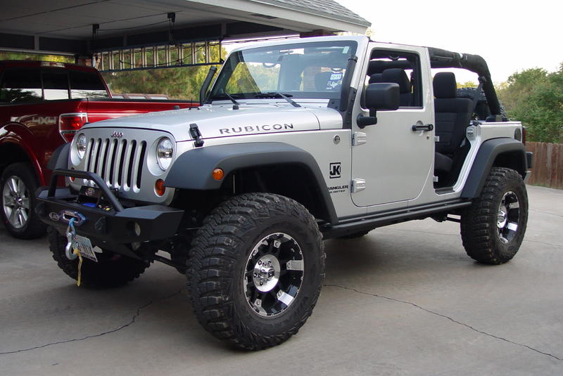

I run a 2.5 TF coil lift along with 1" TF spacers all around. Helps with weight of front and rear bumpers.
