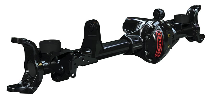

Anybody considering getting one of these?

I personally think it's an intriguing option. I've been running 35's on my Dana 30 for several years now. I regeared to 4.88 a while back with the assumption that my dana 30 would blow up eventually and I'd upgrade to a ProRock. I've been pleasantly surprised at how the Dana 30 has held up since the regear. I haven't done sleeves/gussets so this might be a great option to swap all my components to if I do break/bend something on the stock housing. I'd be curious to see what TeraFlex has to say about what this housing can handle.

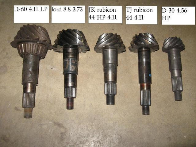

These are from different models but it gives you a pretty good idea of how small the pinion is

Good chart. It's easy to see why the D30 falls short in the strength department.
