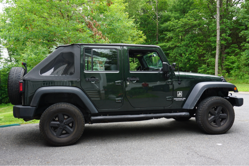

Glad you fixed your problem. I just did the same kit this weekend. Front on Friday night, rear on Saturday morning. I also did it in my garage. I took the wheels off, though. I put it up on jack stands and used the spare tire jack to raise and lower the axle.
Had no problems, but it did take putting the Jeep back on the ground to get the front track bar bolts back in. In the rear, we used some leverage to pull the axle sideways a smidge to line up the hole for the track bar bolt to go through.
Love the lift!
