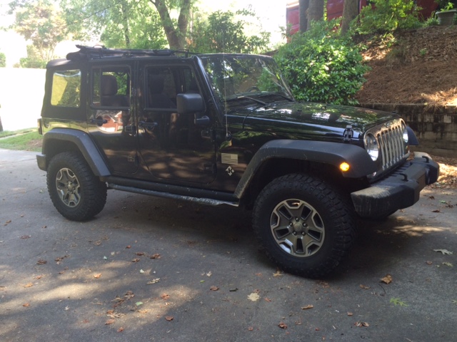

Got the fronts done today! Thankfully didn't have to drop the drive shaft on my '13 JKUR. Did pull the tires, wanted to check torque on my spacers anyway. Love the look with my new 33s!

Name:	Jeep 150515.JPG
JKUR Before
Name:	Jeep 150621 wLeveling Kit.JPG
JKUR After
Leveling Kit, Duratrac 285/70-17s, ~32 psi, stock wheels (w/TPMS) with spacers. Also added Flashpaq to correct tire size and change tune.
Loving this setup! Rides great. Same MPG as before.

Originally Posted by Kojack
NOpe. never jacked the axles off the ground actually. Went around the jeep, unbuttoned the shocks, brake lines and swaybars on 4 corners on the axle. then took my floor jack, with an extension i.e 2x12s nailed together, and cranked one corner at a time. each spring came out, and I had enough to install the spacer on top and repeat on the 4 corners. I guess it would take me 2 hrs to install a lift like mine now....if that. After that, loosen all track bar and control arm bolts, rock back and forth and then retorque. DONE. Easier than going to the store and buying a 12 pak. Front links were just an unbutton and rebutton affair. easy peasy.
That is exactly what I did on my TJ and JK. Work smarter not harder.

Originally Posted by Run2Ga
Wow, so you jacked the jeep up, supported with jack stands, and just lowered the axle and the springs came out? You were able to remove and replace the front swaybar links like this? I'm impressed!
I did the same thing when I put mine on. The shop I bought the kit from said if you can lift it high enough it takes 1 hr. AND THEY WANTED $250
