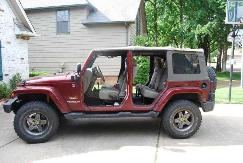

I am no expert, but I did put it on my 07 sahara 4 door a week ago along with OME shocks, for stock to 2". I also put in 1/2" teraflex spacers up front waiting for a new bumper. I like it a lot; it gives me a moderate stance and it rides well with the new shocks, better than stock really. However, caster is now 3.3 on the driver's side and 3.6 on the other, just out of spec range. I plan on getting lower control arms at some point, i thought soon but new tires for our Jetta TDsodden inevitable so further mods willhave to wait until the late summer or fall.
Good news is that I have not had any issues with steering, no flightiness. As others have pointed out to me you don't NEED anything else with is kit, but I think long term it is not a bad idea to adjust the caster back to spec. Some on another thread recommended common sense, that is to try it out and see if you want to add control arms,
When you compare the factory springs with the TF springs it is obvious the improvement, same can be said for the new shocks.
Also a good kit to cut your teeth if your new at doing your own work, like me.
I highly recommend it, it is an improvement over the stock setup. I had it at one field location this weekend and it did nicely, or at least I did notice any issues. It seemed smoother to me on low to moderate terrain.
