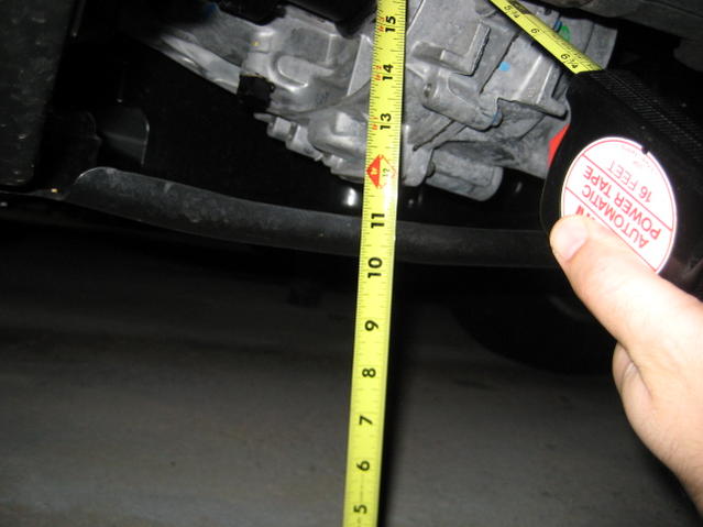

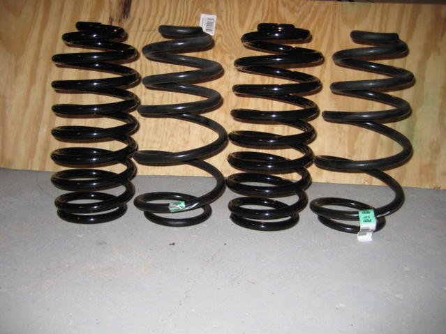

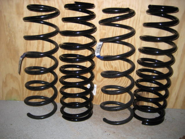

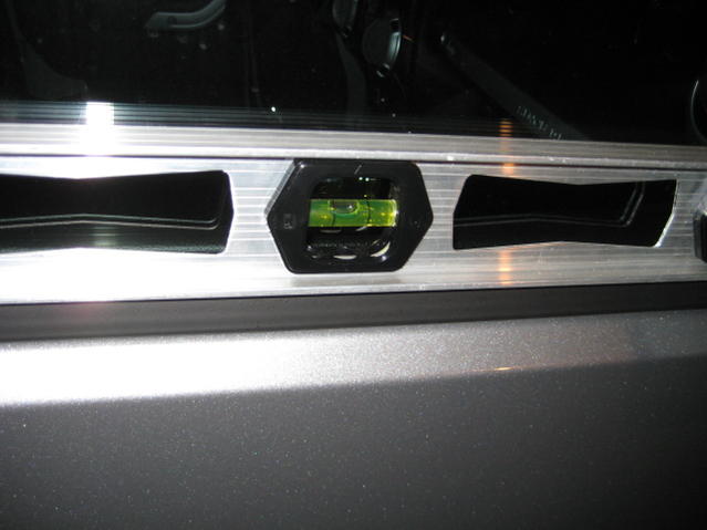

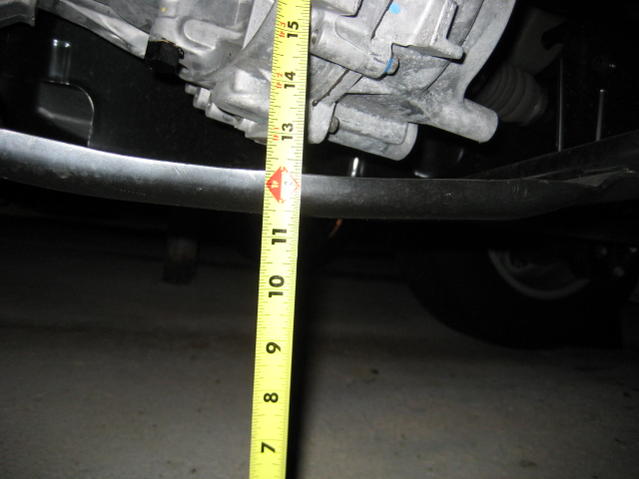

I know it's an old thread, but for those who are looking into Teraflext 1.5 Performance Leveling Kit here is how it compares to stock springs (13 front, 55 rear) that were on my 2013 Sahara 2DR with soft top and towing package. The ride is definitely firmer with stock Sahara shocks and new springs, yet still very comfortable and I like it noticeably more. By the way, based on how far brake lines extend with stock shocks I personally wouldn't be comfortable putting in longer shocks or shock extensions without doing anything to the brake lines.
