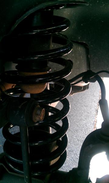

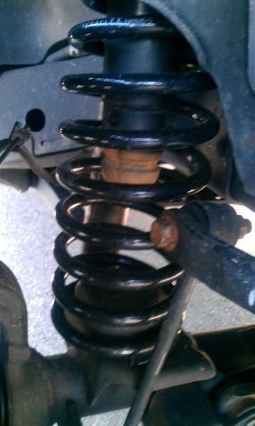

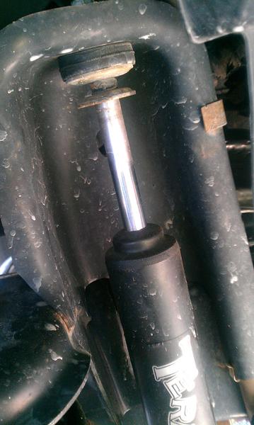

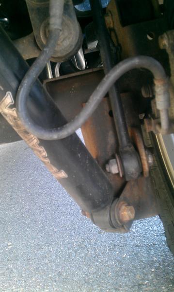

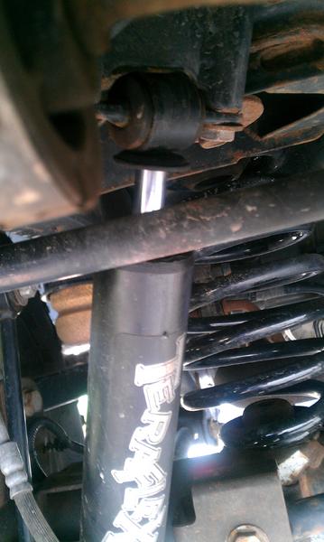

ID:	299939Click image for larger version
ID:	299940Click image for larger version
ID:	299941Click image for larger version
ID:	299942Click image for larger version
