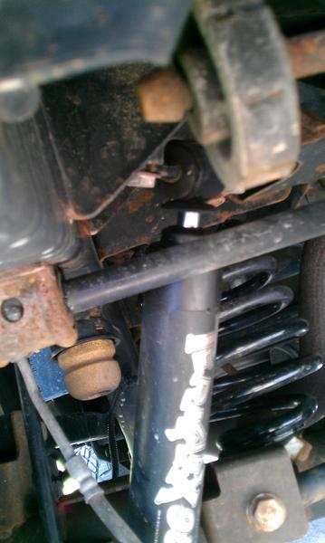

Your rears are way too short. Fronts "look" ok.
Rears are too long**.... Too little shaft showing out the top so their compressed too much... Damn Lyxdexia
I agree, but the front were deadening out just by jumping on the bumper as the rears were obviously with only an inch to travel. So what would you say? Quadratec sent me the wrong shocks?
Good point. If you read like page 2 or w.e the model numbers are for a 3" lift according to TeraFlex, but from Quadratec its just a range from 2.5-4" when TF has separate shocks for each size lift.

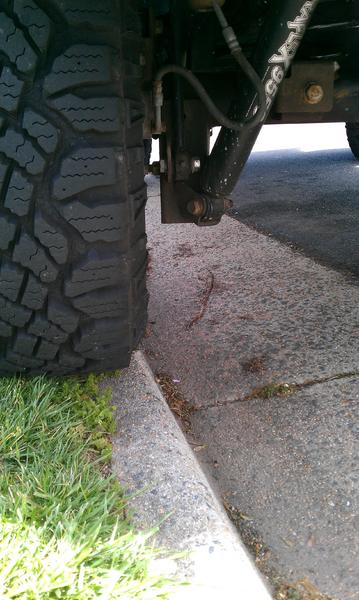

ID:	300066Click image for larger version
ID:	300067Click image for larger version
Here are 3 photos on a 6" curb. Obviously the rear are not right. I guess you would say they are too long therefore there is no stretch to the shock pin and no room for travel.
I think I have at least some more clarrification. I had these shocks on at one point with both the 2.5" spacers in and 2.5-3" springs and had no trouble. My guess is because as I made aware before the quadratec model # for these shocks matches the 3-4" lift on TeraFlex where it should really be matching the 2-3" lift so when I had the spacers and springs on my lift was high enough to utilize the length of the shocks but now without the spacers, they have no room for travel. Any opinion on that?
