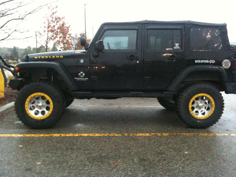

I have the 3" with the 4 control arms(flex arms) with 35" tires and levelled front. I'm 4"+ as far as height gain. In fact I can't even chop my fenders(cause I like that look) or I'd have way too much of a gap.....,, 37's will be my next tire size. Go with the 3" and the 4 flex arms and upgraded track bar.
