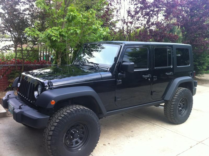

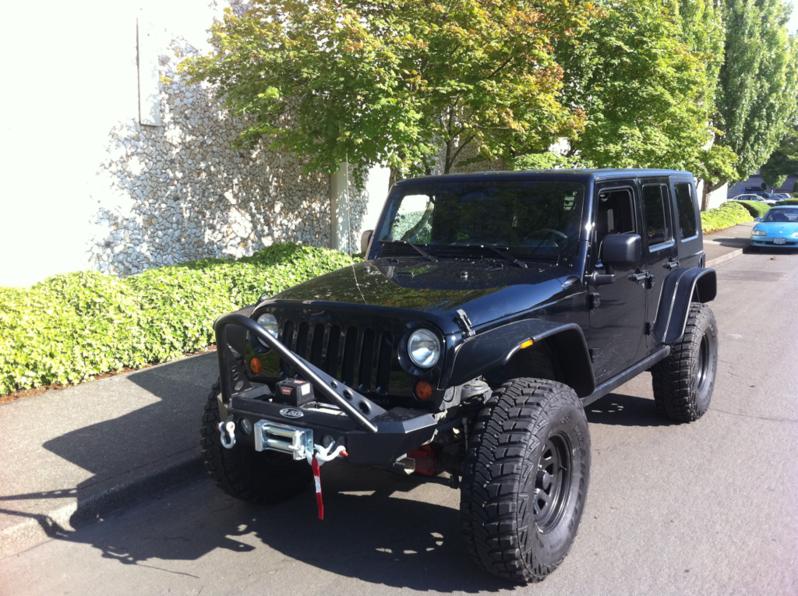

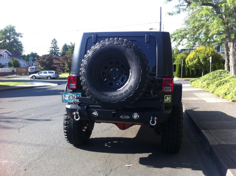

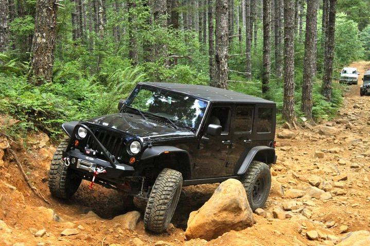

I love my Full Traction lift 3'' lift. I ran 37's just fine with stock fenders, but not aftermarket bumpers. After adding LoD front and rear bumpers I added bushwackers and it gave me the extra clearance I needed.

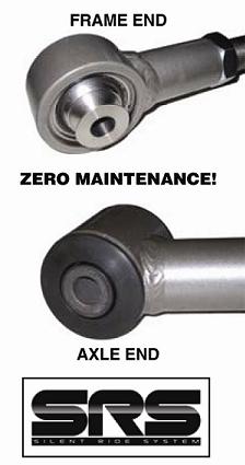

I have over a year on my FT lift and zero issues with my 0% maintenance lift. I am running their economy lift (no aftermarket control arms) and my steering still feels great, like stock if not better.

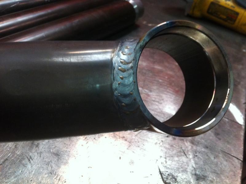

If made in America matters.... We build all of lifts in house. With USA steel
With a 3" kit and 35's its not completely necessary to install uppers and lower control arms. It certainly will dial your ride in perfect. If you decide to run 37's on our 3" kit just install flat fenders. You will need to swap our bumpstops but thats it.
We have a couple options on our 3" kits. The first two kits have the minimum components to properly dial in your ride. The 3rd kit is the most complete kit you can buy.

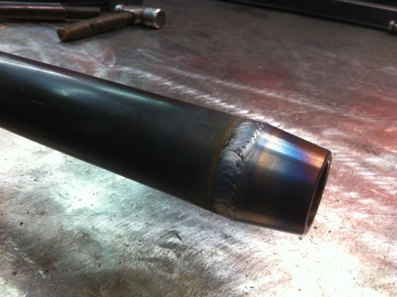

You will need to purchase shocks with any of these kits. We recommend Bilstein 5100's.Click image for larger version

I have the FT premium + with 35s, great kit(it's the one with adjustable uppers). SRS is very convenient, haven't heard anyone with issues. Drives better than stock. I do rub slightly at full flex while turning, on both frame and fender, but I think that has more to do with my wheels then lift...
