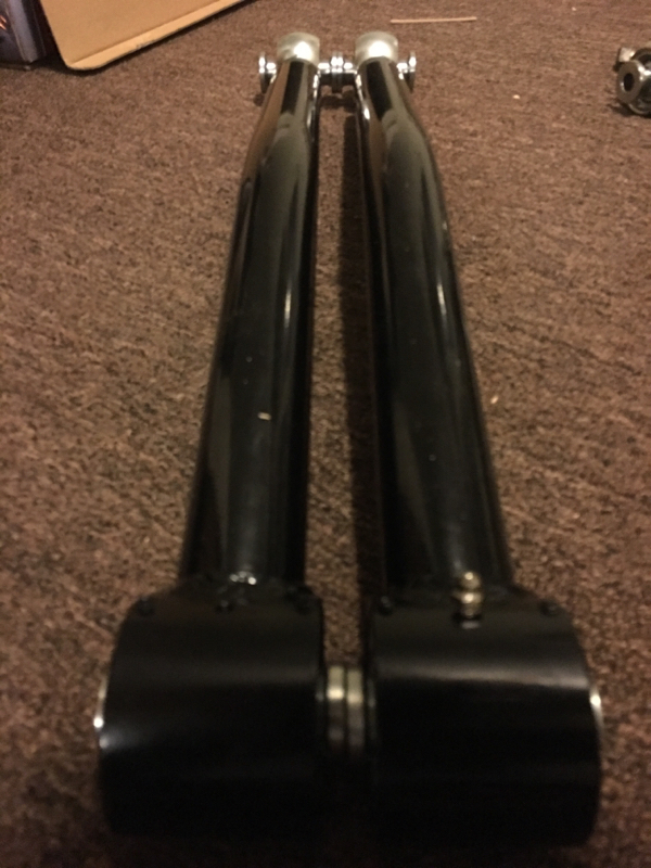

23 1/8 works, just get it close then take both arms, lay them next to each other and slide two bolts through. This will ensure both match in length.
Another tip, replace one at a time. Put a chuck under the tire so the axle doesn't roll forward. If the holes dont line up jack up under the pinion.
Do the same on the other side. Torque all 4 bolts 125 ft lbs.
Good luck ....!

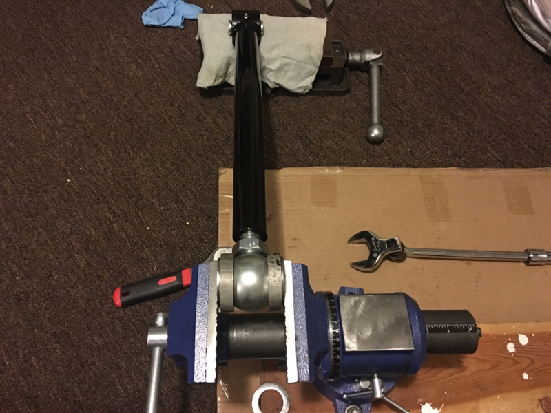

Heres how i achieved 260+ foot pounds on my jam nuts. I always put plenty of anti-seize on the threads, red loctite under the jam nut.
