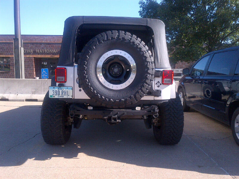

well it dont get much heavier than this 37 13.5 17 on slab and no issues at all

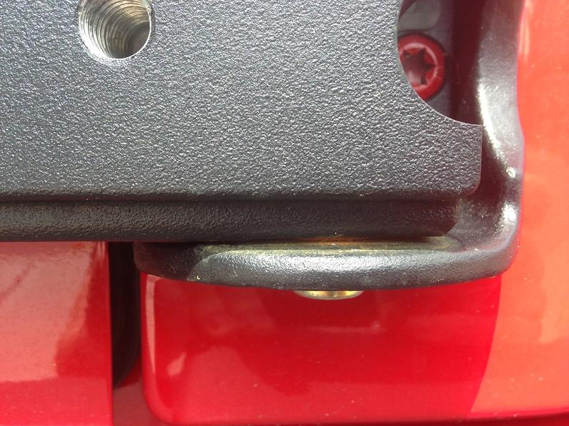

ordered mine in prep for my 35's, its only been on for little over 2 weeks but the hinges themselves are already starting to rust :(

Default rust
that's not cool. I will have to look at mine tonight; however my jeep rarely gets wet lol. I leave the top down 24/7 and drive it when it's sunny out...
some WD-40 lithium may help hold the rust at bay...

Is the hinge rusting or is it the pin and it's staining the hinge?
