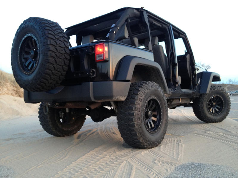

Teraflex HD hinge. You won't be sorry. No squeaks, rattles, clunks, or bangs.
