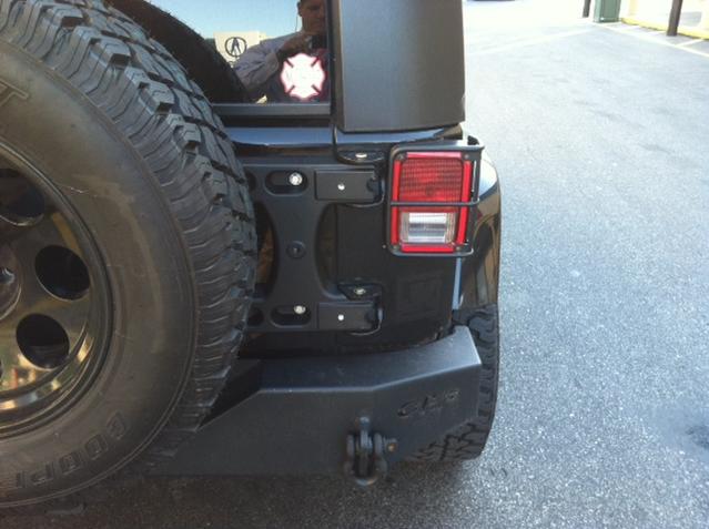

Heres a pic of mine.
There are two spacers for the left side of the bracket to raise it up.
I ordered directly through teraflex but can also get them from off road warehouse
One rubber support gets removed and the other stays on. I have daystar stops so might buy another set since it has to be longer.
Third brake light is still on the original tire carrier.
And the row of holes are supposed to be for additional add ons rotopax and high lift jack that have not been released yet.

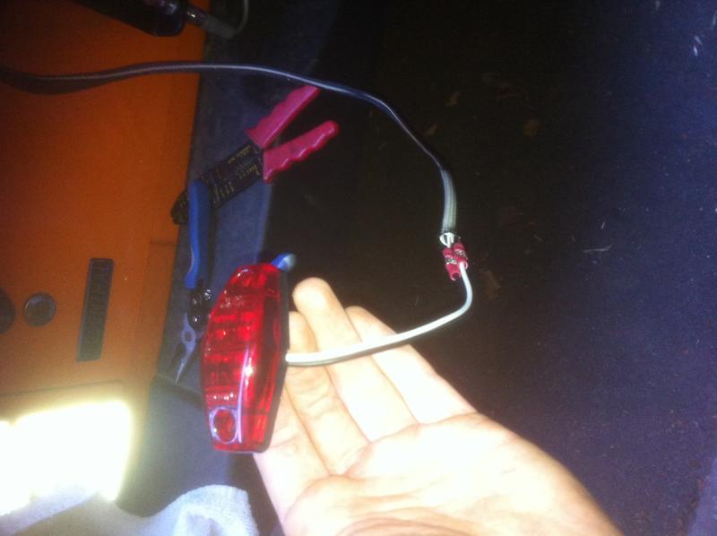

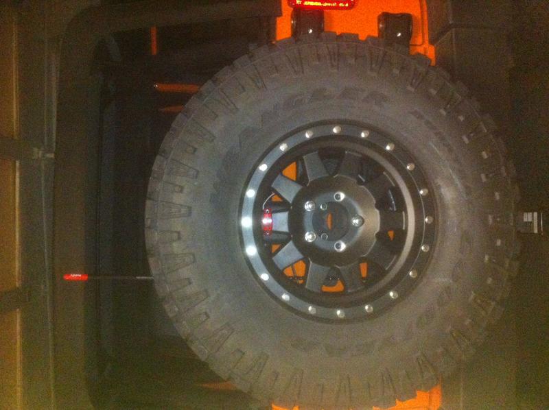

as far as the 3rd brake light goes, i took the stock one out of the arm on the carrier since it was covered up by my tire and wired in a small LED light and put together a bracket to hold it on a spoke of my spare wheel. See pics below
