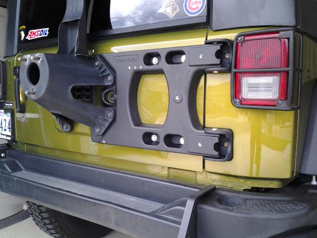

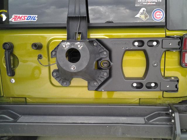

Went super-smooth, guess I got lucky for once. Stout product and perfect for what I was looking for: stock look, strong, while keeping overall weight down and same visibility! Rotopax and CB are next.
ID:	370734   Click image for larger version
ID:	370735   Click image for larger version

Is there any additional support inside on the hinge?
