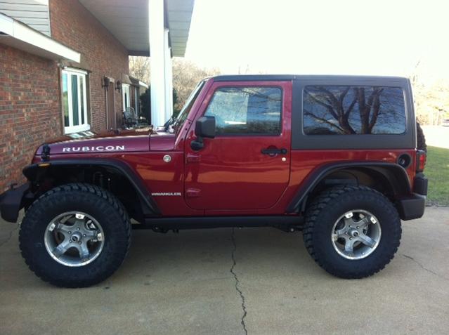

I have a 2012 with Bushwacker flat flares and 315/70/17 Safari TSR's that measure out to 34 inches. They are on Blackrock wheels that have 4.50 Backspacing. Here is a pic with no lift. The only rub I got on the street was it would rarely catch and rub the end of the front bumper.
I have since added an LOD front and rear bumper and a Warn PowerPlant winch. I added an 1 1/2 in up front and 3/4 in in the back. That got me back to stock Height. I haven't wheeled it yet but I know I'm going to have to do the pinch seam cut. I've heard but it might take a 1 1/2 in bumpstop in the rear. I will figure that out in the next couple of days.
