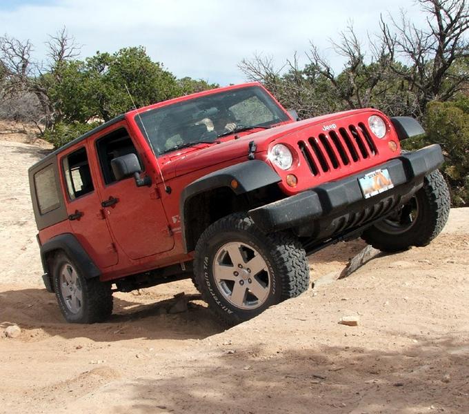

From the TF website:
Details
This leveling kit adds 2" to the front and 1" to the rear effectively leveling the 2 or 4 door's factory rake stance. The kit comes with front sway bar links. You can run a 33-34" tall tire with this kit. If you prefer to run the factory wheels as shown on the red Unlimited, you may need wheel spacers for proper clearance. Fits 2007+ newer Wrangler and Unlimited models

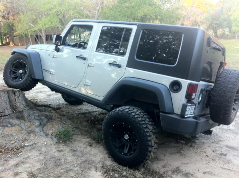

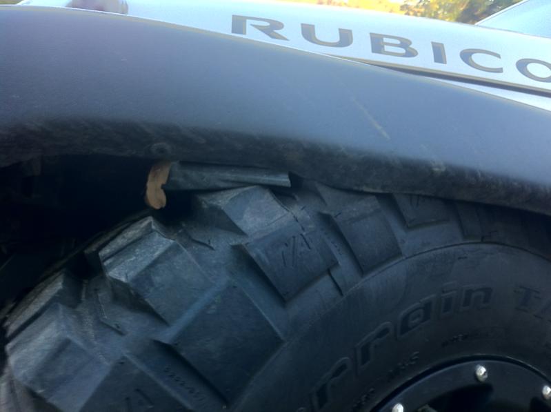

I currently have this lift and it works well. Somehow the zerks keep coming off sway bar links which is VERY annoying.
You will be fine with stock tires and rims.
You WILL rub offroad with this kit if you disconnect with a 33" or 34" tire, even with properly spaced rims. You must increase bumpstops to keep from rubbing, trim your fenders or go aftermarket flat fenders.
I find teraflex's add misleading, they should revise their comments on fitment.
305/65R17 pictured below on my rig. Even with the rub, I like it. I'll trim one day.
