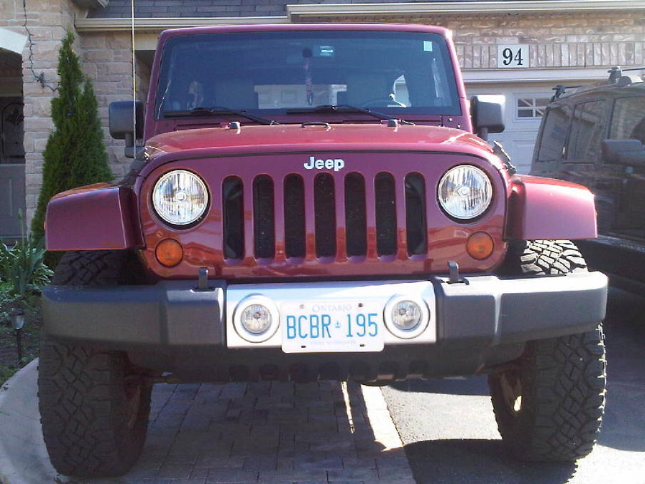

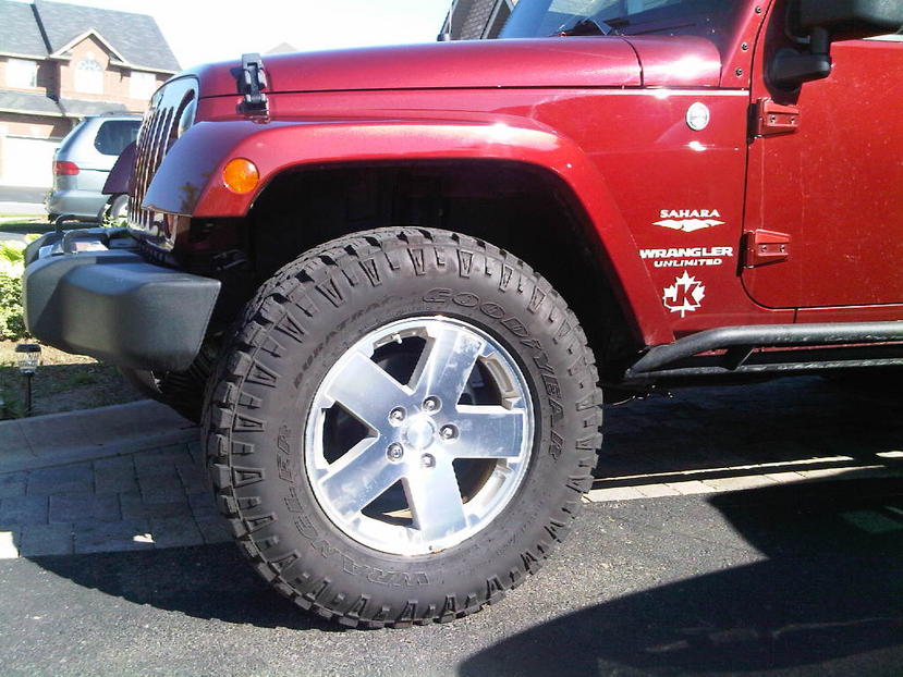

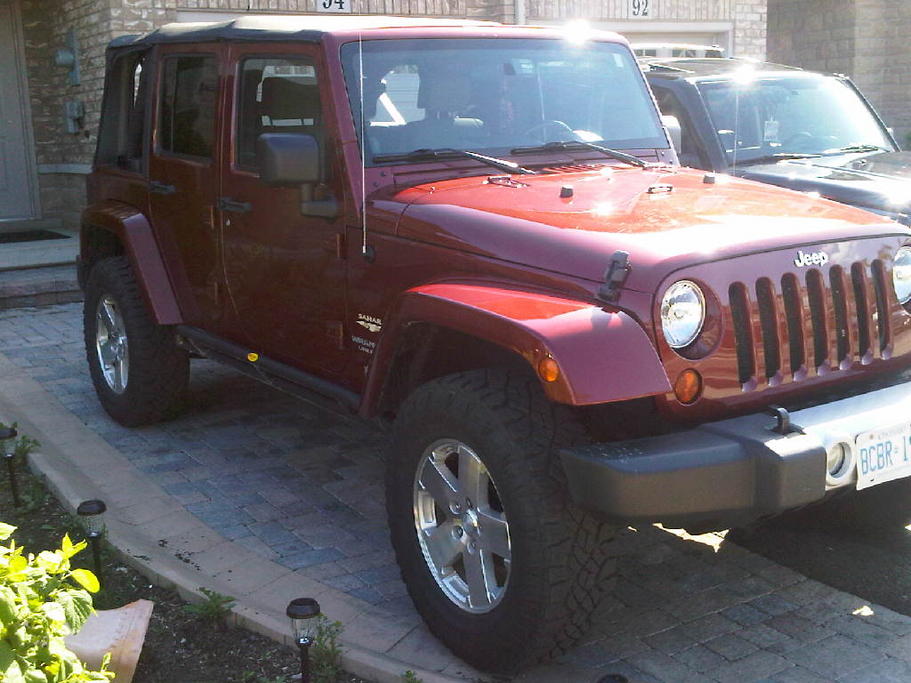

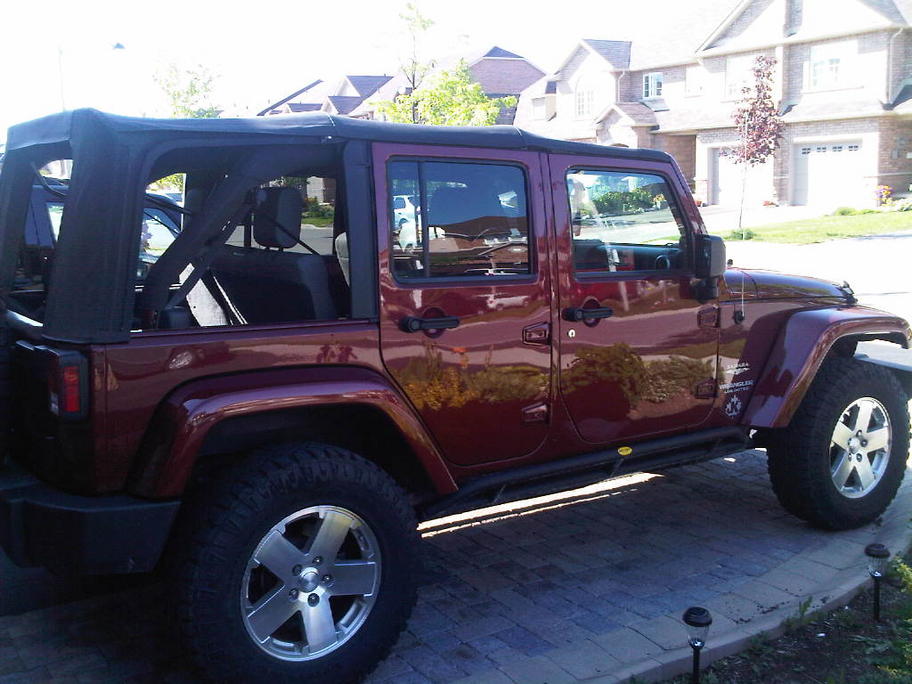

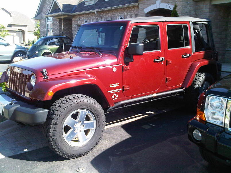

Installed my kit last night.....we took the wheels off and did one side at a time. The first corner took longer but once we completed it....we were pro's and the other sides went on with no problems.....the only thing that sucks...is that I ended up breaking one of the nipples on the sway bar links....now i have to go buy a nipple and fix it. I love the new look....the 33's just filled it up too much so now there is more space
Here are some after pics
