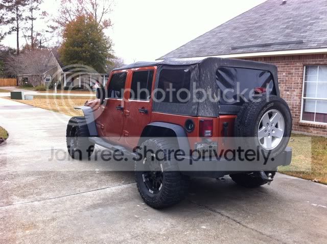

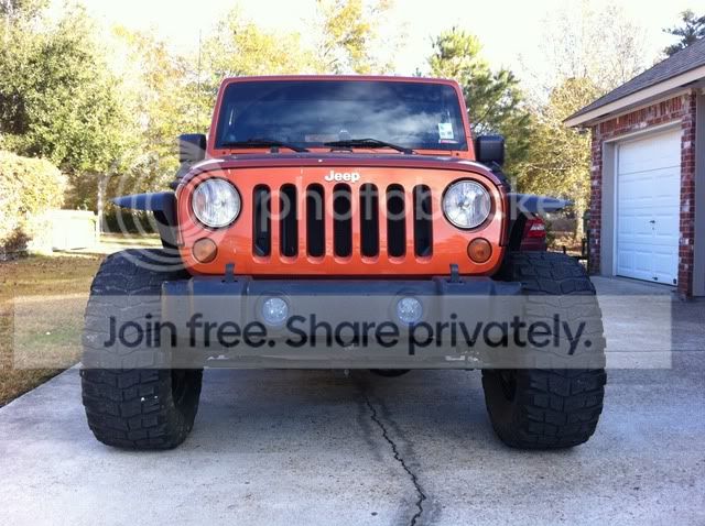

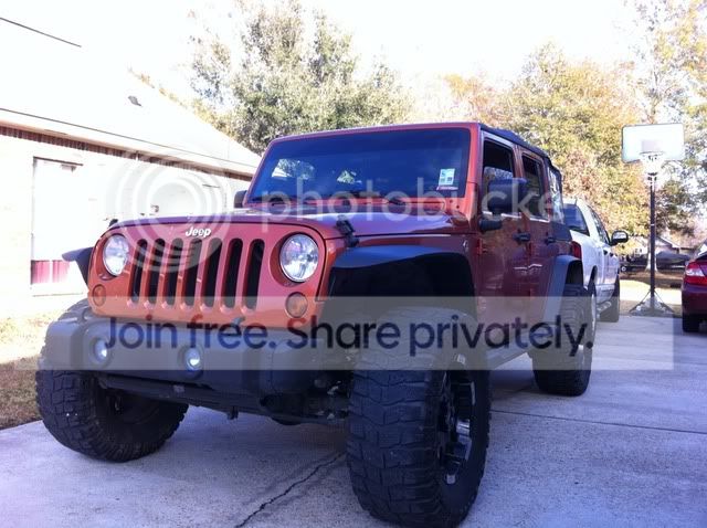

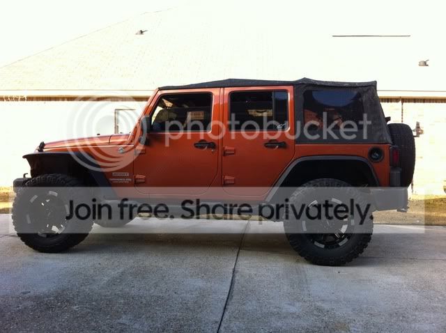

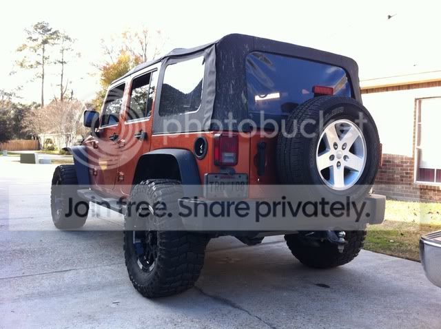

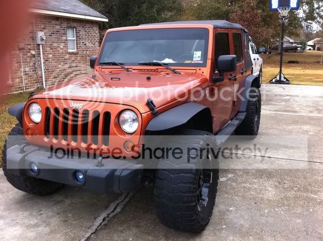

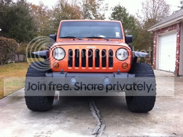

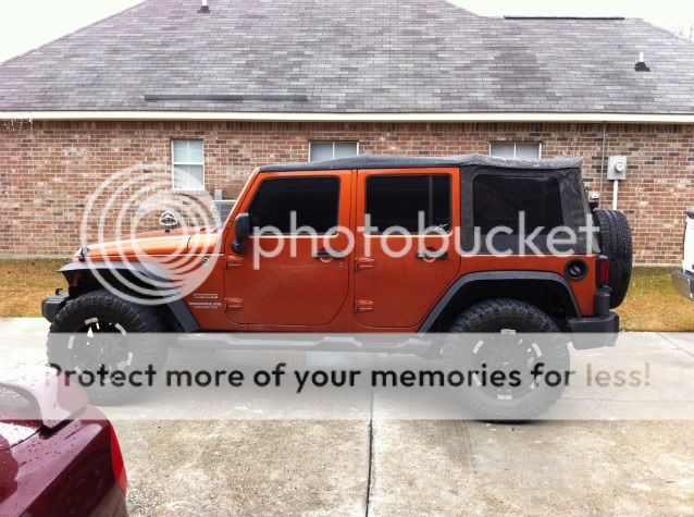

Well I had some budget issues came up after a motorcycle accident so I went this route for the time being.....RK and Marcus at RCO will definitely get my business when the BIG lift goes on....So here's some pics for now. Took me about 2.5 hours by myself using the one corner at a time method on the front and I managed to do the rears at the same time....I tried to take as close BEFORE and AFTER pics as I could manage. Pics are from different times so there are some shadows casting. Enjoy!
I like the way that looks with the chopped fenders. Did you use the spacer levevling kit or the spring one? Been thinking about building mine using the spring kit plus a 1" BL to give alittle more room, for the 35's
